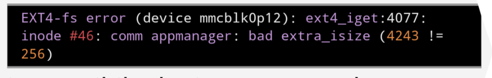

Hi, I connected my medianav to securecrt because is unable to boot and I see only blank screen with hour on top right corner.
I get this error with that /navi partition
Anyone can help me? ThanksIMG_20230412_005730.thumb.png.69fd13318122aa2898f37bfe5615fd7a.png
