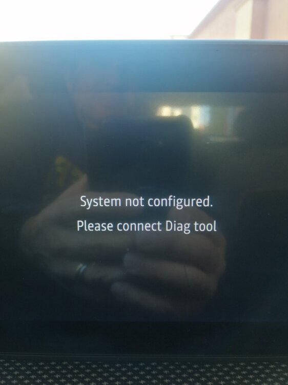

Buonasera a tutti, chiedo cortésmente, se è possible sapere come si puó fare ad riconfigurare anche il media display della sandero 3 serie con il sistema n 6.0.9.7 ,perchè anche io ho lo stesso problema, allego la foto del display. ringrazio in anticipo .

Hi i have problem its appear   system not configured  , media nav evolution 9.1.3

On 6/21/2022 at 6:39 AM, lotfree said:
Connect diag tool - how to fix Medianav EVO
how to fix Connect diag tool in Medianav Evolution using MICOM config.
First of all, we launch WinCE. For example, using Bootloader, which must first be installed.
or usnig winCE
read the topic how to enter winCE 👇
Download dmicom_test_evo.txt
to a USB flash drive , insert it into the switched off Medianav, run it, and wait until the desktop appears.
Now we copy the MICOM config itself to the Storage Card, from where we launch it.
In MICOM, set all the necessary parameters and save (Enregistrer button).
Then go to the Tuning tab and write the data to your DSI_config, in the system folder.
In the Reset ECU tab, click the buttons in order as in the photo below.
Ready! The medianav will reboot and there will be no more Connect diag tool.
